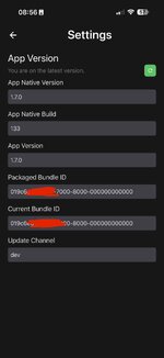

didnt know the 1.7.0 is out right now... i have the 1.6.0 and no updates available
But I already do 😎
It's possible that the ability to connect was patched out in version 1.7.0, so be careful with the bike update for now if you want to continue using the app.

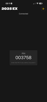

I have only this screen… (bluetooth connection hardening?)
But I already do 😎
Ah well most certainly its them enabling the new BLE stuff I saw before. When I have time I'll look into the 2.8.x app versions and see what it takes to replicate/support in Svag.

So I just installed the app on my PIxel 9 and was able to connect to the bike but all I see is this..... though mine is the MX
Does it show as "2025 EX" in the main list and does your VIN show UDUEX at the start? Usually the connecting screen getting stuck means you aren't close enough to the bike, or you might need to "forget" the bike from your list of saved bluetooth devices and try reconnecting.
I have exactly the same issue with my Android phone. Connection screen comes up as normal, but once you push "connect" the empty screen like above is all I get. Connected the bike to the charger and checked my charging parameters with Svag, let the bike charge over night where it automatically updated to the 1.7.1 FW and the next day Svag would not show data anymore. I will try the suggestions above, but I'm almost 100% sure it was the FW update that caused this.
SVAG works for me on 1.7.1 and 3.0 Try this. Complete power off of Stark. Open SVAG, then power on Stark, quickly before Varg app opens, when SVAG show "connect" press and it will open.
I have de 1.7.1 in my mx 1.0 svag work fine
I was using a different phone to be able to use the SVAG and RaceChrono as split screen, and on a Samsung S23 this method does not work. However I tried with the Arkenstone and it works!
The bummer is that I didnt figured out a way to not have the Varg app open at all. I can split screen it with the SVAG or Racechrono, however I can't get just thr SVAG with the Racechrono. Do anyone know how to exclude the Varg app after starting or get the android controls back to change apps?
Could the new update disabled the bike to connect to other android phones?
