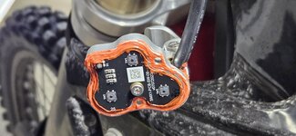

@fsfs. What's your take on any potential side effects from sealing the connectors, pcb, casings with a sealant like rtv silicone? That of course excludes any switch/light surfaces. Does this inhibit or promote long term corrosion? I think preventing water from getting below the upper triple clamp entry point is key. But why not just dab silicone at all entry points if this is a known issue? I already did this to my bike but the fact others aren't talking about this as a solution makes me wonder if I am missing something.
The connectors are supposed to be IP67. If the connectors do not seal that is because of poor wire/cable choice (like improper outer diameter) or poor assembly. This weekend I will post a few photos of possible solutions/aids.

Thank you for the write up and suggestion. I have a question or two if you don't mind. Since the connectors seem to have issues only when washing the bike ( that's my experience) and not from riding in the rain...
1.Could we seal the box underneath the number plate with silicone so water doesn't go in there, even closed cell epdm foam could be cut to fit inside and act as a second barrier before water or moisture gets to the 3 plugs.
2. Washing the bike and covering the switch on the handle bar with a bag so water doesn't get to it might be the best prevention?

Water ingress can be both "acute" and "chronic" let's say. With acute being it won't work after being pressure washed, and chronic being it works but gradually degrades from corrosion. I would avoid pressure washing around critical areas even if you pack the connectors with grease. I wouldn't declare the connectors problem free wrt to rain, etc, because the bikes are generally new and should last several years. How the connectors will hold up after a number of years remains to be seen.
If you must pressure wash i think covering known problem components is a good idea.
