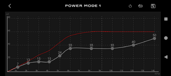

I made this advanced map for hill climbs and it worked surprisingly well for me on my first outing. Is it better than just switching to a basic map at 15-20hp when needed? Maybe, maybe not, but I am having fun playing with all the features while they are free!
