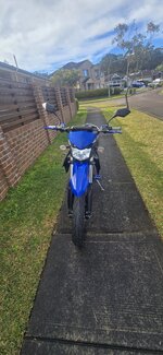

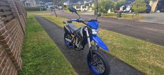

Dave from Sydney Australia, new to the forum. Central Coast area to be more specific.

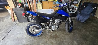

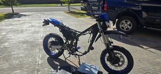

I am embarking on my 1st EV build and thought i would share some pics of donar bike and the like.
Plus ask some questions about the votol controller and programming interface.
Donar bike is a KLX250SF 2011 (im not sure why they were label SF here in Australia) but its a super moto.
Young fella i brought it from, just put new brand new pirelli's on it and 12 months rego, then lost his license.
16000km or 10,000 miles for you non metric users out there, came with the trail 21 and 18 inch rims also.
She runs ok i have a klx09 250 with a bill blue 351cc big bore kit at a mates farm(ranch) and thats a different beast.
So Kawasaki brought these out in 2010 and 2011 in Blue here in Australia, from my best research and understanding approx only 250 of these where imported and sold in Australia.
Unsure why they stopped maybe the Green trail model was just selling so much better with the lower price point. Due to the low volume the blue plastics are no longer stocked as spares.
I am going to wrap some of these in a blue carbon look vinyl.

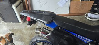

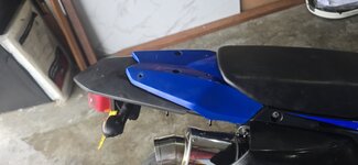

Will tidy up the tail as shown in pics with one piece rear fender, and replace the metal fuel/gas tank with a plastic one with kayak access hatch for storage.

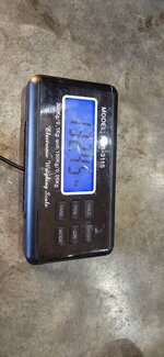

Last night i topped her up with fuel and weighed her, quite heavy 132.45kg or 291.5lbs.
As the project progress's i will update weight changes, im sure to loose at least 50kg or 110lbs from removing motor/exhaust, radiator and coolant overflow bottle, airbox and carb, plus the tank full of fuel.
battery motor and controller = approx 30kg/66lbs. So 110kg/242lbs would be great final weight.

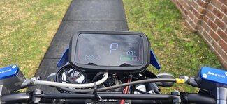

Struggling trying to get display to show anyting but voltage, have checked one lin from controller connector to rear of display i opened the display DN7 and continuity checked was fine.
can i used a multimeter on single wire to display to check if mode 1,2,3 and sport are sending signal to display. voltage or amps. resistance how does the single wire output to display to show modes and park as such ?

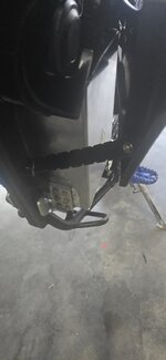

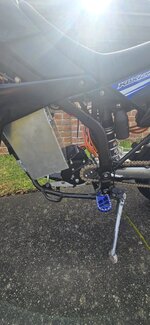

  1. The petrol engine and all related items have been removed, lost 60kg inc fuel tank and exhaust/radiator/airbox etc. estimates are 30kg lighter when EV.

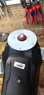

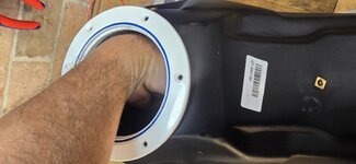

  2. New plastic fuel tank will be used as glove box (4in access hatch to paint) and have the main shutoff switch on top see pics, this will lead to a contactor allowing 72v to flow to the controller from the battery the switch is removable.

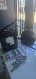

  3. Battery from Amorge has arrived 72v 48ah built in BMS and circuit breaker, 19kg total. uses QS8 plugs for anti spark when connecting.
  4. New ignition key switch has 2 normally open, normally closed pairs, 1 pair for the 12v system and the other for the 72v side. so the starting sequence will be key on then shutoff switch on.
  5. Bike is wired so that when the stand is down, the controller is locked in park mode thus no Turkey can just twist the throttle and the bike takes off.
  6. Diode has been placed inline with 72v to 12v step down transformer no back feed possible.
  7. All 12v has been rewired, as the original harness was worth saving for resale due to so many non applicable connections. using orginal left hand controllers as indicator switch as push to reset easier and supplied left hand throttle.
  8. Registration reqirements here require odometer readings, i pulled orginal klx dash so had to source a small gauge (2in/52mm) like version that you can input old odometer reading, as they would not pass a vechicle that one year had 15000km on it and the next year had 2000km at annual rego inspection. You cant modify odometer reading on the DKD or DN7 as far as i know
  9. 12volt cabling runs on the left of the frame, with 72v in yellow on the right.
  10. vinyl wrap carbon fibre blue pattern to be applied to selected plastics.
Just awaiting replacement controller as current em260s doesnt show modes or speed using one-lin, supplier James @ Dun has been very helpful in customer service and sending the replacement after trying many options.
Motor mount is being made with Derek @ lithium king and shipping with heavy duty 12 and 14 tooth 520 sprockets.

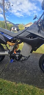

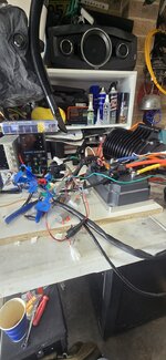

Update, been working hard over the past few days wiring, getting everything rough wired and placed into bike.
It now runs as I had planned, just awaiting bracket and sprockets from Derek at lithium king.
Should be test riding by the weekend.

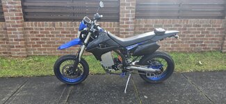

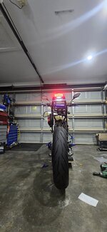

OK she's finished for now as we had to leave chilly Sydney for Bali to warm up, pics attached below.
Once she's wrapped I will update.
Certification is booked infor 5th September.

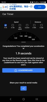

Thanks Don for all your help that Tune file works well, I ran out of road so upon my return will do 100km/h run.
Off to ride Mt Batu Volcano in a few days, hopefully Wayan (last pic) as my guide

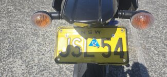

Once back to reality I had the task of seeing a certified engineer (@$750 aud or $500 USD) to give the bike a tick of approval with Service NSW (aussie version of DMV). the engineer was happy with bike and thought the shower drain grate was a good work around for sprocket cover. He asked me to shrink wrap the thin metal strips i used to support the front shrouds and get a certified weight bridge ticket. once that was done he sent me the paperwork.
I went to Service NSW (DMV) and present all the paper work and they infromed me that i had all the correct paper work, yet no one had done this prior at that branch, thus paper work was sent to head office and i was told not to place EV triangle on license plate until they call me. They never called, yet i notice an update online to the rego.
So bikes all legal eagle now, any other Aussie members on the forum feel free to get in touch if you need help with certification, i found this to be the hardest hurdle.
