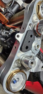

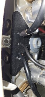

3d printing a solution for water intrusion into the connector box.

This is gen 1. Gen 2 is made from TPU which actually turned out to be too flexible. The holes need slits to be able to slide the wires in as the connectors are obviously way bigger than the wires. I may try a 2 part thing that locks together. It's purpose is mainly to be able to wash the bike without worrying about water blasting in there. So it doesn't have to be water tight, just water resistant. I also siliconed the connectors inside which more or less protects everything. I had a weird error code a while back so I am paranoid about any water now. Same went for the map switch. As soon as I siliconed inside and out I haven't had a single issue washing the bike. Still working on a file I can share for others to 3d print.

Looks good. Thanks for sharing pics. I pressure wash my bikes cause I'm lazy, even though I know it can be bad for pushing dirt places it shouldn't go. So having something like this seems a good idea.
