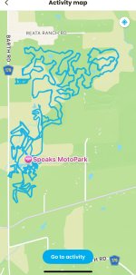

Power setting is a minor factor, I leave mine on 60 all the time, I control it with my wrist rather than a setting.
This week I did 29+ miles and finished with 48% battery, a mix of hard pack single track, a flat track, and 3 loose MX tracks over 3 hours with stops. This seems to have surprised some owners who don't get this kind of range. I'm a slow old guy, 68 and C speed.
The key is no wheelspin and lowering the engine revs. If I would have done this gearing mod just for the rideability (it was never bad) it would have been worth it. Obviously the range is a benefit. I don't even bring my generator anymore, and have never needed it.
With the most torque in any dirt bike ever (including a Maico 700) this thing can absolutely pull the gearing, and I feel like Stark has made a big mistake with stock gearing. A side benefit is moving the rear axle all the way back to improve the rear suspension and minimize wheelies. The throttle response is much less sensitive to little inputs and irregularities from trail chop, so it's less tiring and faster and more effective.
Flame on if you want, but you can try it yourself for under $100.
