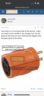

Went to Home Depot and followed the Alta adapter plug directions laid out on here by the OG forum members.
It is the same wiring and anyone looking to get hands on one can make it for pretty cheap at Home Depot.
I attached the diagram I used for this that I found by @schwankl

I'm running into the same issue. The 120v adapter the dealer gave me has the X and Y pins switched from the diagram above, but they were at least able to get it from 20%-52% overnight so I assume that's not the issue. I got it home and can't even get charging to start- just a yellow light.

IMG_7817.jpegHey all. Also having the non charging issue. This is the first time I’m charging it. The 120 adapter I was using had the ground correct but the hot and neutral switched from the diagram above. I resolved that and still no charge.
I then pulled apart the plug on the charger and just going by wire color, it looks like it is wired wrong from the factory as can be seen in picture. I would like to confirm that before changing anything. Can anyone with a working charger undo the two screws in the plug and pull apart and confirm wire colors/locations? This all assumes they landed wires correctly inside the charger too.

View attachment 11550Hey all. Also having the non charging issue. This is the first time I’m charging it. The 120 adapter I was using had the ground correct but the hot and neutral switched from the diagram above. I resolved that and still no charge.
