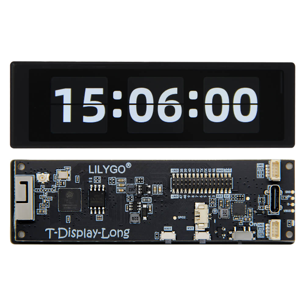

I saw in multiple threads a discussion about an alternative for the mobile. I like to share my solution for this as I am also not a big fan on the MX for this. Also CEO said in an interview that they do not plan to develop any small display.
I connected my display between the VCU and the phone bracket. CAN is running surprisingly on 1MBaud instead of typically 500k. Anyhow, listening some messages and result was easy. Of course the wireless charging pad needs to stay at the bike. It works in parallel to the mobile as my display only listen.
For me important was:
1. SOC
2.Mode (1,2,3,4,5)
Additionally I found also Speed and status. For the status I receive values (neutral, active etc..) but I was not so interested.
I do not want to replace the mobile completely and I do not want to write to CAN.. just listening.
For the HW I took the ESP32. The display I tried 2-3 different version and finally took the LilyGo:
Housing is 3D printed designed by myself. Of course you need a small DC/DC (12V-->3.3V) converter and a CAN transceiver (I took the Sn655hvd230).
As a SW base I took it from Volos Projects:
Basically all the credits goes to him and his channel and in this specific case also ti nikthefix... Great guys!
On the picture you can see SOC=26% in Mode 3 (my personal 50hp setting tuned in the mobile). My display is faster (a few ms) than the mobile because it is hard wired :)!

With this information it should be easy to use any CAN Display like M5Stack. I like the OLED and the screen ratio therefore I went the longer way
To make this clear. it has also some side effects. I do not receive any warning because I do not have the mobile with me while riding. (e.g. water pump error) luckily I (hopefully) had never some. As far as I see also the hour counter does not go up. Also no GPS states etc. are working... All for me not important. I have this setup roughly 1 year running without any trouble.. like my Stark MX

- in the first step I made a Y-cable because I do not want to cut the original harness. Aliexpress is full of this connector: You have to take the 4 pin.
But connector Y-cable was too bulky. So finally I cut the wire of the wireless charging station direct after the connector and soldered +/- 12V and CAN H/L . In case of warranty I could buy a new one for 150€ and no one would realize any modification. I doubt that any ecu will detect an error due to additional reading. I did not find any OBD connector on the MX. But as I said, all at your own risk.

i have a full time job plus a "4 kids + dog family", so my spare time is very limited :). I definitely have no plans to commercializing anything but I have no problems to share my results.
- The display hardware you can order here:
T-Display S3 Long
- STL: No Problem to share. See attachment. It was my first try with Freecad half a year ago. Maybe it makes sense to design it new. Anyhow, all your own decision.
- For the CAN Bus, all information are already shared in my first post.
- Power supply:
https://a.aliexpress.com/_EuGtA8O
-CAN transceiver
https://a.aliexpress.com/_EJY3nkE
- Software: This is for me the critical part. I am not deep enough in license things and I have no time to dive in too much. I used a couple of libs (basically all in Arduino available) but I do not know the conditions. Anyone a clou?
