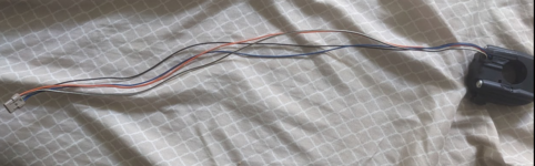

So this is a stock harness from my spares, the wiring is continious through the entire loom:
What that looks like is the connector (see the beige conn at the end) between the harness main and the switchgear has been compromised/damaged.
So that being said - color codes to match:
