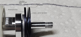

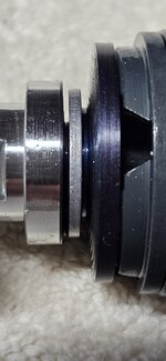

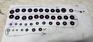

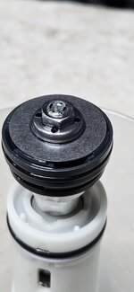

This is basically what I did. There are 20 face shims. From my understanding all the bikes have the same shim stack, it is just the springs and clicker settings that change between the soft/medium/hard options. I brought it down to 8 followed by a crossover made from the last small washer before the LSV starts. There are 3 of the same shims and I used one of those. Followed by 2 face shims and then just add the stock order. You're just making sure there is enough thread to torque the nut without hitting the shoulder of the shaft. That 6mm aluminum piece is very fragile. Red loctite and be careful. I think its 25 INCH pounds. I went from the stock 4.8 to 4.4 springs. Check eBay for your springs as they are way cheaper with free shipping than from Racetech. This is all on the base valve, nothing done to the mid valve.

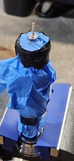

When filing the peen down you want to retain the center peen, only file outside! The picture shows a toothpick (foam ear plug works even better) in the center and glove/tape wrapped around the rest of it to keep shavings from getting anywhere.

For the rear shock I kept my spring and did something very similar where I used the last shim in the stack as a crossover and removed 3 face shims from the compression side and added 2 after the cross over. I left the rebound as is.
