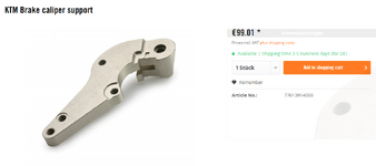

im seeing that this disc need the Galfer SP066 adapter but is out of stock everywhere? how did you guys mount this disc?
Yes, This is the disc I ordered. I got the KTM brembo spacer. part number 77013914000. The disc is 4.5mm while the stock is 3mm so there was a little rub on the caliper spacer at first. I shimmed the wheel 1mm away from the disc side fork, but eventually removed approx 0.5mm of material from the caliper spacer where the disc rubbed.
Appears to be exactly yours?
Yes!
Dave told me that and i bought it (I'm not blaming him), but I don't understand how he managed to install it with the same disc as me without any problems. I have a picture of his setup.

Check if your wheel is in dead centre.
Maybe even have the hub moved a bit to make sure that hub and disc are in their centres.
Thank you for the help guys, the disk was a little bit to the left, but cant be fixed, i sand by 2mm the adapter to make a gap and now is working fine... the other solution was buying the Galfer SP066 adapter but is out of stock everywhere
