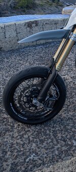

for the brakes i choose probably the most expensive but most convenient solution: All stock and the EX set up but a secondary full brake set up on SM... 320mm rotor, wheel spacer, axial to radial bracket, Stark's Brembo Master cylinder and an Accossato caliper, (the Stark brembo caliper doesnt fit, much wider and it touches the spokes even with spacers)
with a secondary full brake set up i "just" need to change wheels, dismount the radial adapter, put the stock one and dismount the master cylinder and caliper together, is very easy, just have to unhook it from the front plateholder
