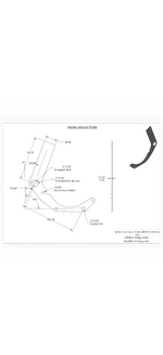

3d modeling my own brackets (with a little jumpstart from @Dave Daum with the battery cage side panel. Also someone had the motor brackets posted here. But I can’t remember who.

Lithium-king.com makes motor mounts, $150 for your bike. Text them with your measurement from bottom mount bolt center to swingarm bolt center. I bring a leg up the back to support the battery. I don’t like to have the battery touch the motor to transfer heat. I just ordered one yesterday for a 2009 KTM
I know that!
Why spend $150 when I can design and have them made for $10?
Battery isn’t directly touching the motor, though the bracket is. I’m not worried about that heat transfer. If anything the bracket will act as extra air cooling heatsink as it is aluminum.
No different than the tried and true E&C YZEMX that I have.
What’s the recommended distance from the swing arm pivot? And
What’s the recommended distance from the swing arm pivot? And height?
I recommend taking the motorcycle, placed on aevel surface, with the motor installed, and measuring the distances. Good rule of thumb is to keep the sprocket teeth as close to the swingarm as possible. Set the vertical position so the center of the counterpart sprocket and swingarm pivot are on the same plane. Hope this helps.
