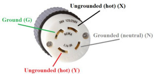

The USA Stark charger uses an L14-30 plug, but they usually supply an adapter to regular household 120v (5-15).I did find a plug adapter that goes from the stark plug to a standard household plug
Thanks for the help I will either get the big generator or just get the small one that only uses the household plug but take twice as long which is fine I only play ride 30 minutes here then hang out camping with the kids and grandkids then 2 hours later maybe a 30 minute ride .The USA Stark charger uses an L14-30 plug, but they usually supply an adapter to regular household 120v (5-15).
Some of the standard L14-30 to 5-15 adapters won't work, there are threads on this forum you should be able to find.
The reason they don't work is that they connect the L14-30 neutral (which is not used at all in the Stark plug) to the 5-15 neutral.
If you want to go from L14-30 to TT-30 in one adapter, you may have to make it yourself, which would be very easy.
You just have to know that the Stark charger only has 3 wires; ground and L1 and L2 (or X and Y as shown below), on 120v L1 and L2 become hot and neutral (of course ground is ground in all cases).
View attachment 15344View attachment 15345View attachment 15346
