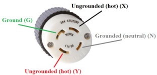

I wanted to go from 120/240 30 amp to which I believe is the starks male plug to a 120/30 amp rv plug I am trying to save weight when buying a generator and the big 120/240 are heavy verses the 120 volt 30 amp generators
314
I did find a plug adapter that goes from the stark plug to a standard household plug
The USA Stark charger uses an L14-30 plug, but they usually supply an adapter to regular household 120v (5-15).
Some of the standard L14-30 to 5-15 adapters won't work, there are threads on this forum you should be able to find.
The reason they don't work is that they connect the L14-30 neutral (which is not used at all in the Stark plug) to the 5-15 neutral.
If you want to go from L14-30 to TT-30 in one adapter, you may have to make it yourself, which would be very easy.
You just have to know that the Stark charger only has 3 wires; ground and L1 and L2 (or X and Y as shown below), on 120v L1 and L2 become hot and neutral (of course ground is ground in all cases).
View attachment 15344View attachment 15345View attachment 15346
