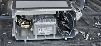

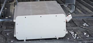

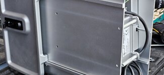

I started by removing the four larger bolts that hold the charge housing into the stand. But, like mentioned, I then started to remove the T30 bolts from the front of the charger housing only to find out it was unnecessary (and the two side ones are hard to get to because the bracket lips block access to the bolt head). Also noted those bolts didn't have any washers on them like the bolts on the back).
I put them back in and started removing the bolts from the rear of the charger housing. These had been installed through a black foam gasket and so punched out a sticky little bit of foam that stuck to the end of the bolt.

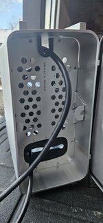

Then I removed the four bolts holding in the legs of the charger itself. The 240v cord easily pulled through it's opening as I pulled out the charger from the housing, but the bike charger connector could not fit through it's opening until the U shaped trim gasket was removed (see next post's images).
In images that others have moved these into a case, they don't have the silver/aluminum protector that is mounted to the fan in my below pics. Likely because that makes the charger too tall for the popular 6" tall cases that are used like the Harbor Freight 3800 and 4800 cases. With that shroud, my charger is over 7" tall.
Dimension of the charger itself, rounded to the nearest 1/2": 9.5"L x 9.5"W x 7"T.
I'm looking around for cases that are 8" or taller so I can keep on this shroud and stack the cords on top of that. Think I may have found one.
The Seahorse SW540. Interior: 13.5 x 9.9 x 8.4”
Seahorse SE540 Waterproof Protective Case (13.5 x 9.9 x 8.4”)
But at $76, it's about double the price of the Harbor Freight 3800 case, so maybe I'll just pull that shroud off to get it to fit in the HB 3800 or 4800 which have the following interior dimension:
HB Apache 3800: 14 7/8"L x 10 5/8"W x 6 1/8" T - $40 (regular price, but they do on sale a lot
HB Apache 4800: 17 7/8"L x 12 5/8"W x 6 1/8" T - $60

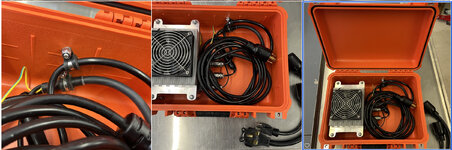

These are both super nice solutions. Curious if anyone has done this in any other cases? Have seen the examples of simply adding handles to the OEM aluminum case after removing it from the stand, but looking for something with a bit more protection. I like the idea of having these fulling encased and protected, though I've seen some that have cut holes in the carrying case so the charger can potentially be run with the case closed.

I am super happy how my Harbor Freight 3800 case turned out. It is more compact and easier to use than the Alta's Rapid Charger, which was the old benchmark for a dirt bike charger, and which had zero complaints about it, only praises.
@Philip @Fog 25 I assume you are drilling the bottom of the case and bolting down the charger with the OEM bolts? And maybe adding a fender washer with rubber casket or fender washer with a dab of silicon caulk to seal?
Used the bolts with washers cut up a small plastic bucket (sides) for the cable protection. No need for silicon.

I drilled a couple of holes in my case for a zip tie to secure the charging cable in place. The cause is not IP67 now, maybe like IP65 or something. The four bolts at the bottom are the original Stark charger bolts, no fender washers, but I Loctited them so as not to lose them because the plastic case is too soft, so they cannot be torqued properly.
I could have used some countersunk and recessed shoulder washers, but that would have been too fancy. The stock charger bolts are working just fine.
