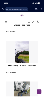

I used this on my 500 and will be transferring it over to EX, it’s not the cheapest option, but it works well and I have no interest in getting sliced open from a rigid mounted plate.
