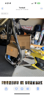

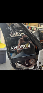

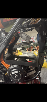

I tried the same thing by cutting that frame bracket out thinking I could get a bigger battery in the frame. I found that battery was smaller than the way I ended up with.
Here are some pictures of the cut out frame and cardboard battery mock up. Another problem was getting the battery into the opening.
Also I had an Alta, I feel that 96 volts and peak 400 amps is pretty darn close to Alta power, it can pull wheelies at just about any speed.

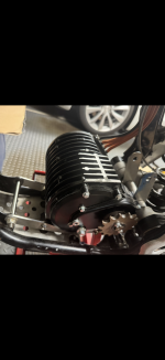

For reference, I made a cardboard cutout to the exact dimensions of the qs165 60h v3. Here it is lined up in the frame. This is why I may need to extend the battery up into the frame rails. I also don't mind making an odd shaped battery if necessary, fatter below the rails, and narrower up in between the rails. Time will tell, lots left to do. Still need to buy the motor and controller before anything else, and adjust plans as necessary.
Two things I can say is: I'm not a fan of the cable location on the motor, but I love the location of the mounting points. Absolutely no need for attaching anything to the case of the motor, just use the 3 main intended mounts. You can see why I'm not gonna make brackets like you guys use with the 138, but rather will just weld tabs to the frame for the front mounts, and make ">" brackets for the two rear mounts to the swingarm bolt and possibly to the frame as well or instead. In fact, the more I think about it, the more I realize that it might be best to not even attach anything to the swingarm bolt, and just make frame mounts all around. Doing this also would allow for pretty easy adjustment side to side by merely altering spacer thickness. I'll be using 22mm-26mm OD x 10mm ID spacers wherever they're needed. Thicker the wall, the more stable and stronger they'll be.

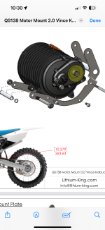

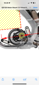

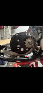

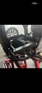

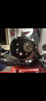

It is working really well, it’s made out of steel angle iron, I think 1-1/8” but I can’t remember.
It bolts to the motor mounts at the front of the frame. At the back I had lithium king make an extension on QS138 mount where the battery frame connects.
To keep it from flipping around I have a Velcro strap across the top.
