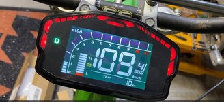

Hi All,
First of all, I need to give a huge shout out and A HUGE thank you! to @DonCox for his work on these conversions and build threads that he posts. I have experience in building batteries, working with Motors, ESC's, VESC's, other controllers and electronics in general, and had been thinking about building an electric dirt bike for awhile, then after stumbling onto this forum, and studying Dons work on his conversions are what inspired me to finally go for it!
I am using the Votol EM260S and QS138 70H V3 (latest "updated version") for this build, along with 2 - 20s8p Molicel P42A batteries connected in parallel with 2 ANT BMS 130A for charge only (20s16P total). This has been a very fun build, and i have enjoyed it thoroughly and learned a lot on this journey! On my next build and for anyone considering doing a conversion like this, please take my advise and go with a newer style (split upper frame) chassis for the donor bike. The battery was by far the most challenging part for me, and it wasn't necessarily the battery build itself, it was cramming as much battery as i could into what would fit in this 08 chassis, if i could have just built a tall, rectangular shaped battery that fit vertically between the upper chassis would have been so much easier, and IMO looks much cleaner as well.
All in all, I am very happy with how it turned out, and it absolutely rips!!
