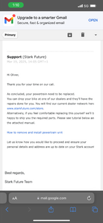

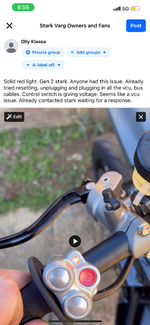

Got the solid red light. Still awaiting for starks reply. Tried resetting, unplugging and plugging back in vcu, bus cable nothing. Probably vcu problem. Literally yesterday was working perfectly, charged it over night, boom turn it on and solid red light.

It’s going to be an issue with the powertrain. The issue came back and stark sent me a new powertrain. They said that the thermal sensor in the inverter was faulty. Stark had said that when it’s a solid red light it has to do with an overheating issue.
iofel
London
Bummer. Thanks for the help. Will keep posted when stark replies!
