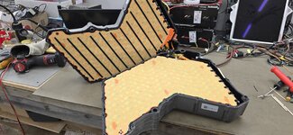

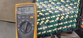

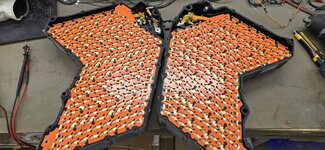

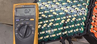

So I opened the pack and found four cells are shorted and completely empty. The pack is 100S4P split into two halves. Total of 400 21700 cells. There's a BMS board on both halves of the pack that monitors the voltages and balances the pack. I though the empty cells might prevent the pack from starting so I bypassed those and made a temporary fix to replace those dead cells with some Tesla cells I had and balanced the voltage to match the other cells of the pack.
I was hoping this would do the trick but I was no lucky, still getting the red light. Now I believe the battery may be in some sort of fault state and would require manual reset, perhaps with some service/diagnostic tool - similar to what car manufacturers use. Also Tesla packs need to be cleared from some latching alerts after repairing them.

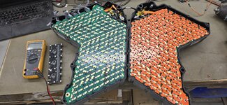

In my build I need to build my own pack with fewer cells to make them fit on the small moped frame. I was hoping I could have used the Stark BMS and VCU since they are the only ones that I know are able to control the Stark inverter.
Both halves have their own BMS board
Dead, shorted cells.

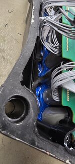

Cells are glued to the case from the negative end of the cell. This will cool down the cells when the air cools the battery case. I assume the battery might overheat on a long ride under heavy load.
