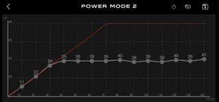

The red line is basically like a dyno chart of a Varg at full throttle. Like you would expect from a synchronous motor, up to half the rpms there is constant torque, which makes the power curve a straight line with some slope, since
power = torque * rpm * a constant
ane when torque is a constant, too you end up with the equation of a straight line:
power = rpm * a constant
That also means constant acceleration because tractive force = torque / wheel radius.
Then, from half the rpms to maximum rpms there is constant power, which means that the acceleration becomes weaker as the speed increases.
For motocross I’d say that one needs less torque and therefore less power at lower rpms because the maximum available makes the bike oversteering easily; for enduro maybe you want the torque to wheelie easier.

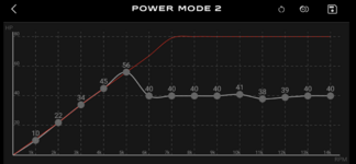

so how would you configure a throttle curve making it most easy to lift th front wheel with 40hp max? Imho max hp at the beginning? Like shown in the pic?
or would you even go above 40 hp like this`?

What do the standard modes look like, for instance what's the "factory" 40 hp power curve?
They are all the same and look like this. Intererstingly the advanced mode setting doesn't affect the standard mode setting, so if you configure 80 hp max in advanced mode the standard mode stays at 60.
This would feel like you are in the 80 hp mode until 4K or 5K RPM, which is way too fast, probably 40 - 50 km/h.
You should try maximizing only the low-rpm power, the very first 1K RPM point.
626
For easier wheelies I would guess stick to the red curve from the beginning until maybe 2-3k rpm... hard to say if you don't know at which rpm you are when you quickly open the throttle in an effort to lift the front wheel.
Then of course that would be your wheelie map but could cause some issues in other situations.
Does 60 hp standard map hug the red line initially?
Another way to look at it could be to mimick standard 60 hp or 80 hp map at low rpm then revert to something like standard 40 hp for higher rpm. This should get you snappy 40 hp don't you think?
