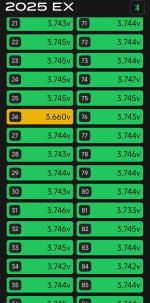

Hmm, it looks like Group #25 is actually group #26, probably starts with group zero?
Yea the numbering is probably off by one.

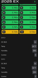

DC BUS 4V ?
Bike is probably off so the contactors are open, that measurement will be garbage in this case.
I don't know enough to say whether that amount of imbalance in one cell group is fatal. It's very possible a proper bottom balance would recover things to a normal level if that cell group isn't actually damaged and just fell weirdly low. There is of course also a slight chance that going too low on SOC (maybe less than 10%) would brick the pack or cause that cell group to do very bad things. I'd say Stark probably has the best advice for your situation but that might be tricky given I assume you have no noticable impact to performance on the bike.

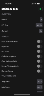

The latest version of the Stark app (2.6.0) has some internal code they added which shows the VCU is now reporting a bunch of battery fault flags like "battery high diff", "battery cells incomplete", etc. The first one would likely be flagged for your bike and the latter would likely be flagged for the two folks who had missing cell groups. I assume in the (hopefully near) future these flags will be used to display warnings in the Stark app, but I didn't see that added as of the moment.
Are you using the iOS or Android app? I'm going to push a new iOS release right now (probably will take at least 24hr for Apple to approve) since that can be done while the primary app release review is ongoing. For android I need to wait as Google has no mechanism for releasing a new (even just test) version while they are actively reviewing a previous version (for the full public app-store release). The new app version shows these flags in the service -> battery page so you can at least check and see if the VCU has also flagged your battery.
I'll probably have to cycle and balance my pack down to close to zero and up to 100 again to see if they level out, my bike is still pretty new and I haven't gone lower than about 30% yet.
Is the numbering off by one in my bike's firmware, or in how the app reads it?
Would you be able to share the APK file as a PM or with a link, so it can be installed directly?
Yep, I sent you off a link to the latest build. And the issue is with my app, the Stark app doesn't reveal the internal pack layout (I just gathered that based on the cell groups on the ends of the two pack sides showing different voltages) or how they identify cells so the in-app numbering is just generated based on how the telemetry displays the cell voltages (as an array of 100 values).

@brongle , it's all fixed in your update now, thanks!
The latest version of the Stark app (2.6.0) has some internal code they added which shows the VCU is now reporting a bunch of battery fault flags like "battery high diff", "battery cells incomplete", etc....
....The new app version shows these flags in the service -> battery page so you can at least check and see if the VCU has also flagged your battery.
On the VCU page, I have no flags. Only on the battery page. I'll post some screenshots for you @brongle of your latest Android update from my phone.

Ah I put them on the battery page under the service menu, should look something like this:
The field names are basically directly what Stark calls them so I'm not 100% sure what "No Vicor" (voltage?) and Danger Score (lol) mean.
Bernardo
43
the dc-dc converter.
converting the batteryvoltage 400V to boardvoltage(s) 12V, 5V, whatever
