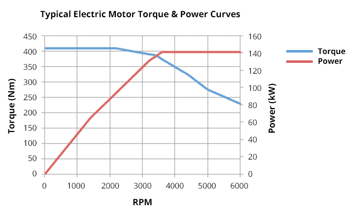

I did a bunch of research on this when I was exploring the inverter/motor parameters the VCU exports. I am very much a novice in this area, but the points that stuck with me are:
  • Electric motors have a much wider range of performance properties than you might assume. Even small changes in the make-up of an electric motor can drastically change its efficiency band, performance, etc.
  • Most people that talk about this stuff are looking at motor performance in isolation. The inverter (or controller) performance and losses are also important when considering overall efficiency and power use.
  • On my EX swapping to 15/44 was a significant enough change in range performance (for my pure street use, on supermotos, etc disclaimers) that I noticed it for a few days after. My rough estimates based on Svag telemetry recordings was 5% more range from that change. I cruise a lot in 40+ so this makes sense given the next point.
  • I think field weakening is indeed the larger factor to range when considering gearing. I'm not sure if the Stark controller is inefficient, if it's just the way the "tune" works, or what, but my EX loves to dump field weakening in even at lower RPMs. Based on the ratio between ID/IQ my guess was the Stark motor efficiency band is somewhere around 6-9k RPM, and likely a 200-500 RPM range sweet spot.
