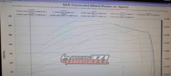

The horsepower curve is also not flat. It is an actual curve. Just look up that dyno i posted not that long ago.
Edit: Here it is:
The top ond is the 80hp, wich you can see collide with the 60 and 70hp near the end.

Torque is also relative to wheelspeed. On a EV the torque kurve goes down softly from its max at 0rpm. And your measured HP curve is as flat as the regulation of the electronics allow. But much flatter than in an ICE engine.

Sure it is relative to the wheelspeed, but is dictated by what the motor delivers and further modified by gearing. That is not something we were discussing was it?
The curve is very smooth, but far from flat. The lower ones are quite flat sure, but the top one is most certainly an curve. Stretched out over a way longer speed range than any ICE, but again that was not something we were discussing.
You can also clearly see the 80 hp collide with the 60 and 70 hp. That's where you see there surely no longer is any regulation on the output as it is just the maximum it can do. I am actually pretty sure the 80hp output is the max of the motor, or at least it will be after some laps. Power clearly drops after some use on 80hp.
My guess is the flatting instead of hyperboleing in the middle is due to limitations of the battery pack. That's also the area where we most often have the most noticeable powerdrops in SM.

HP is also dictated by what the motor delivers. And by the gearing. HP is independent from the gearing of the motor. Therefore it is so useful to characterize an engine. Just one single number.
