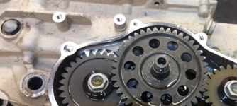

Just removed my powertrain to replace it on warranty because of moisture in the inverter. Multiple cracks on the black plastic cover around mounting bolts. But the most interesting thing is that I can't see eny atmospheric venting in the structure. Is there one and have I just not found it or what? I'm not a hard core pro on these but I used to work in a prototype shop that mostly built vehicle prototypes and one thing I've learned from enclosed spaces is that they do not work. They need a breathing system, most commonly used system is gore vents, a small vent that has Goretex membrane in it to let gases exchange but keeps fluid out. An example in the left upper corner of this photo of KTM Freeride. If there is no vent, just the thermal expansion of the inside air could explain the cracks in the cover. Enough bending back and fourth and fractures will occur.
