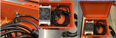

@Philip @Fog 25 I assume you are drilling the bottom of the case and bolting down the charger with the OEM bolts? And maybe adding a fender washer with rubber casket or fender washer with a dab of silicon caulk to seal?
I drilled a couple of holes in my case for a zip tie to secure the charging cable in place. The cause is not IP67 now, maybe like IP65 or something. The four bolts at the bottom are the original Stark charger bolts, no fender washers, but I Loctited them so as not to lose them because the plastic case is too soft, so they cannot be torqued properly.
I could have used some countersunk and recessed shoulder washers, but that would have been too fancy. The stock charger bolts are working just fine.
