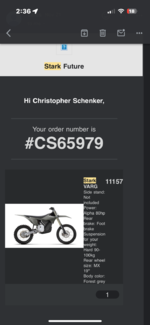

Got bike delivered however they sent me the wrong bike. 60 hp and wrong suspension specs. I ordered an alpha 80 hp. And phone won’t connect either. It’s the wrong bike and I hope they correct this issue or I’m not gonna pay reminding we

Did you actually check that it was 60 or was that in the documentation? My documentation said 60 but I got an Alpha. The dealership I got my bike from straightened out the paperwork for me. It is only a firmware upgrade to enable Alpha anyway that should be easy for them to remedy if so.
Does your bike power up ok? Is it just that the phone won't connect? What did you get for suspension specs?

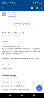

Two images I posted are my actual order and what came in the box The Phone won’t connect at all to the bike. I tried everything. I took it for a ride and on a full charge it died on me 2 miles from my house What. A bummer that was

Are you getting help directly from Stark factory support? They should be able to log into your bike and straighten it out or at least address it. These bikes have generally been rock solid and they do have pretty good support from the factory.
The bikes also come with warranties which is uncommon for OHVs and Stark has been pretty good about getting folks up and running if they have issues. Folks have gotten full core parts replaced from the factory if there were problems. That wouldn't happen if you were on a KTM the struggle with those jackasses is legendary.
Let us know how it works out for you.
