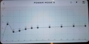

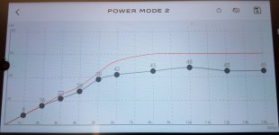

Personally I think the advanced power modes are just there to highly individualize the power output and not to create universally better power than the stock Stark modes. So IMO it doesn't make a lot of sense to just copy someone's else advanced power curve as part of the effectiveness is the process to create and understand this specific power curve yourself. But since OpaTsupa asked me to do so in another thread, here you go:
This is my preferred power curve to have a "light" front end, yet maintain traction and have enough power on tap for steep climbs:
This is what I found best for me to have great front end traction in the slow stuff, help on slow downhills but still maintain a more two stroke like feel in flowy stuff:
Don't expect any description on how if feels and why, if interested you have to try it yourself.
