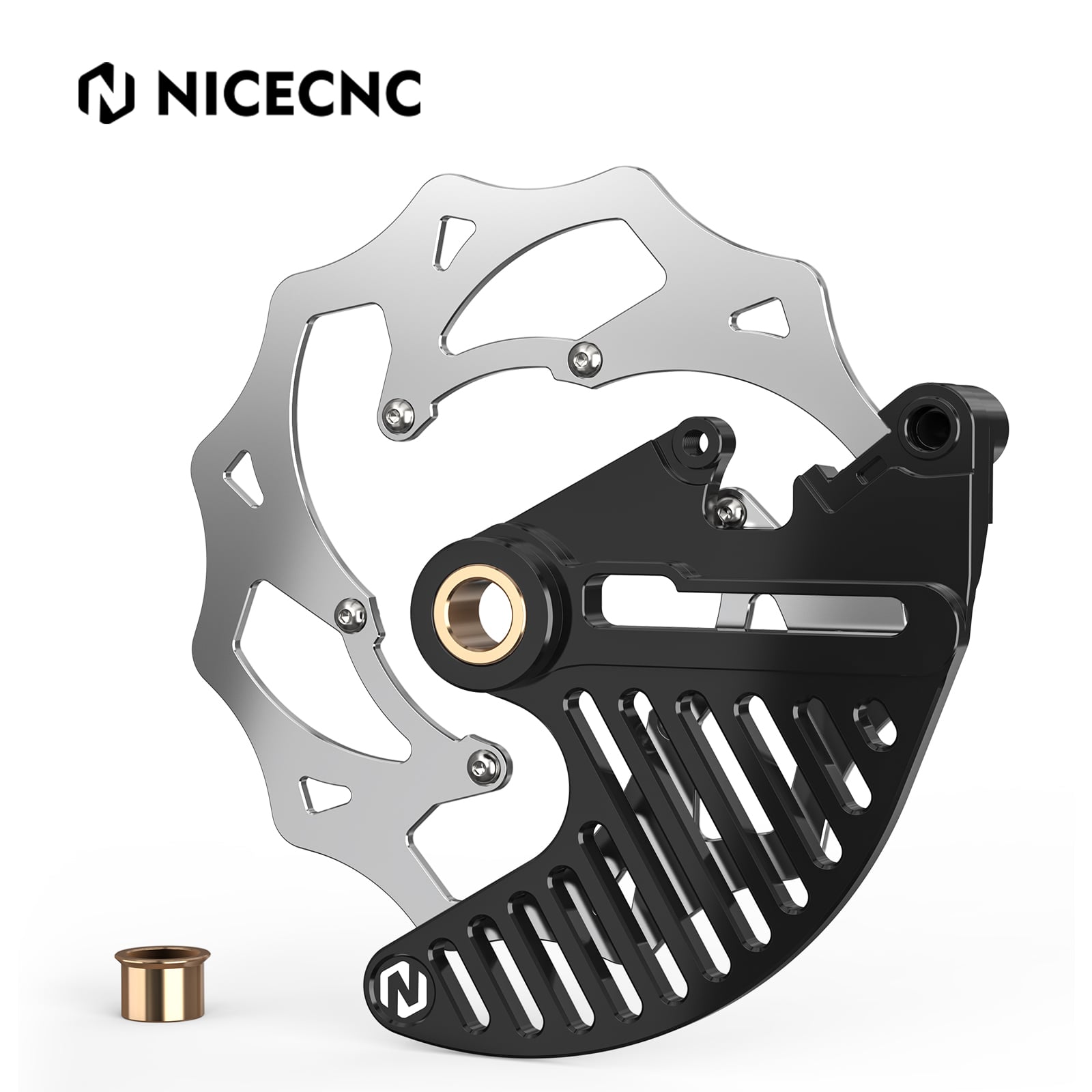

I'm pretty picky about my brake setup and I will say an oversized rear brake rotor was the ticket for me. I can lock the rear wheel with a single finger and it has great feel (not affiliated in any way).
After my second ride with the Varg, I'm finding I'm loving the LHRB, but would like a little more power for my old fingers. Just to confirm, the KTM/Husky/GasGas oversized rotor and bracket work with the Stark Varg? For $99 that is deal!

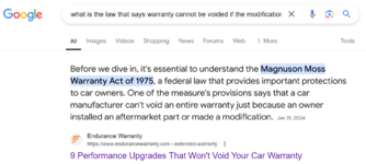

I contacted SV about larger rotor kit and they told me doing so would void the warranty. From a design stand point, moving the caliper out gives the caliper more leverage relative to the rotor. This in turn reduces the reaction forces at the swing arm mounts. I don't see a problem with this. I guess they got to go with the canned warranty warning.
4,419
Bull :poop:. They'd have to prove that your mod caused a problem being claimed under warranty.

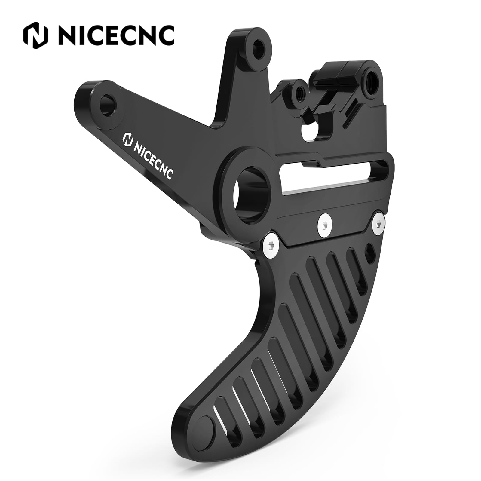

The stock rear caliper fit and mounted perfectly. But the dual-piston front Brembo caliper did not fit on either my Stark or my Alta. It looks like there is a design flaw and the ears of the "stunt" bracket are about 1.0 mm too close to the face of the brake disk. I sent an email to NiceCNC... hoping to receive an answer on Monday.
NiceCNC offered to refund me $15, LOL, which was their Labor Day discount, but they refused to fix the "stunt caliper" portion of their bracket. I would have to mill 1mm off of that bracket to make it fit. I also had to dremel the Brembo bracket to clear the brake disk mounting bolts. It is not a bolt-on solution, it needs work. I will be away for a few weeks, but I will post another update in about a month to let you know how it worked.

Just installed mine. The hole pattern on the rear rotor was just slightly off. The rotor screws just barely fit. You can see in the attached images that the screw heads are not perfectly centered in the rotor counterbores.
4,419
Yuck! This is not great. I had enough bad experiences in my racing career with poorly machined parts to know this could cause trouble. There could be too much shear stress on one 6mm bolt that receives all the braking force. Keep an eye on these bolts to make sure they stay tight.
