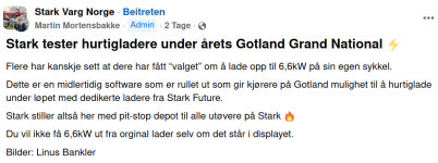

Stark mobile charger is out !
108

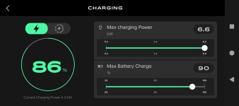

its software bug, It is not possisble with single socket/single charger
3,3kW on 230V - real current 14,3A from socket - I put once 20A on shucko for experiments - I use high quality audio plug and 4mm wires - it works but socket and terminals was VERY VERY HOT
I cant imagine to put 25-28A on regular outlet

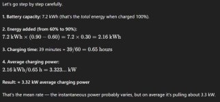

From 60% to 90% = 39 minutes
After 25-30 minutes and around 75% the "current charging power" on the phone started dropping bit by bit, and finished at 3.3kW.
Shuko wall plug temperature rose from 19° to 27°.
Charger temperature from 19° to 37°.
Battery: 19° to 26°.
ChatGPT calculation:
