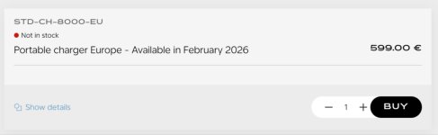

Stark mobile charger is out !

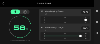

Made me look.
It really is there.
It charged by 2% faster than it took to take a screenshot.
This on 230V / 50Hz / 16A shuko plug.
403
Fun fact is that 16A fuses/safety's don't trip at 16A but much higher. They are just rated 16A.
But you have found out by now.

My MX 1.0 also shows 6.6 now. However tops out at 3.1kW like it allready did before. Have to mention it has been charging with 0,3kW for a couple of hours now. Might be the charger being hot.
Damn i guess it means i really should get that EX. Just extended my warranty with 2 years today. But hey, can't be all that bad of a deal.

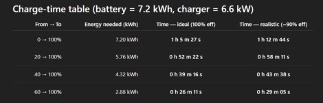

Very interesting.
Considering 75% of 7.2 kwh, i. e. 5.4 kwh, in in 45/60 minutes, it must be indeed charging at more than 5 kw.

A friend of mine, actually charged at 6.6kW and it's working for him, it's drawing 5.9kW and he charged from 10-85 in like 45 min to an hour View attachment 15087
so the Stock Charger is capable of 6.6kwh WTF! jajaja . I am worried that both the cable and the connector could burn, but also the charger components themselves.

A possible explanation is that the Varg app is common to all users and therefore people with a 1.0 have the faster charge option, too, but only people with 1.2 powertrains can use it.

The EX/1.2 drivetrain & pack have supported 6.6kw charging from the getgo, but it was only enabled for some users (mostly Stark staff and I guess a few competitors). I'm guessing this is either a bug on their side with the account-flagging or they are potentially slowly rolling out a higher charge rate. I kind of assumed we'd never get it due to the pack temperature issues but I guess if the charger is properly limiting things when thermals get too high everything should be fine.

On my EX it shows the same now, but as OpaTsupa said this is on an outlet with a 16A fuse - do the math, it is not possible. It is a software bug.
I only had it connected for a few minutes, and it was charging noticeably faster than at 3.3kW. Charger fan came on immediately, unlike at lower power settings.
The "Current charging power" was responding to the slider like usual.
It's raining here for the next week, and I don't need the bike charged up, but anybody with the EX can test it now.
Do you have a method to monitor power output before the charger? Maybe even a one of those smart plugs for a few minutes? [they are risky for serious current]
Regarding shuko plug, I will monitor the temperature next time, and consider installing a more robust plug in it's place. Although, even at this new turbo charging it will be under load for only 70-90 minutes. That shouldn't melt anything unless the wiring and plug are pre-WWII.

It's curious as to why anyone with the current Stark model EVPT23-32010 charger would get more than its rated output of 3.3KW.
According to the charger's manufacturer specifications, it's only rated at 3.3KW, so one would assume that it would not give out any more than that.
Unless it has a temporary surge output or something?
77
Exactly, that's my point of view as well. I have the spec sheet and I have seen the wiring Stark uses inside the charger setup. 5.5kW would be like 50% over spec and using components that more powerful than speced without advertising/utilizing just wouldn't make sense.
I have a clamp meter for amperage so that should be able to shed some light on the issue.
