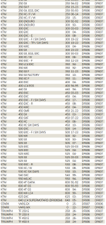

Your recommended option seems good to me: Disc MOTO - Disco flotante aluminio DISC W FLOATING 320X4,5MM
but if you scroll down it says that the Stark model for the front needs to be the "DF 607" for the front, not the "DF606". its confusing... for all other models it says 606 for front and 607 rear, but with stark is the other way around
Captura de pantalla 2025-11-03 121415.pngCaptura de pantalla 2025-11-03 121232.png
"DELANTERO" means FRONT and TRASERO means REAR... Front is the left number of 607 for Varg :unsure:
