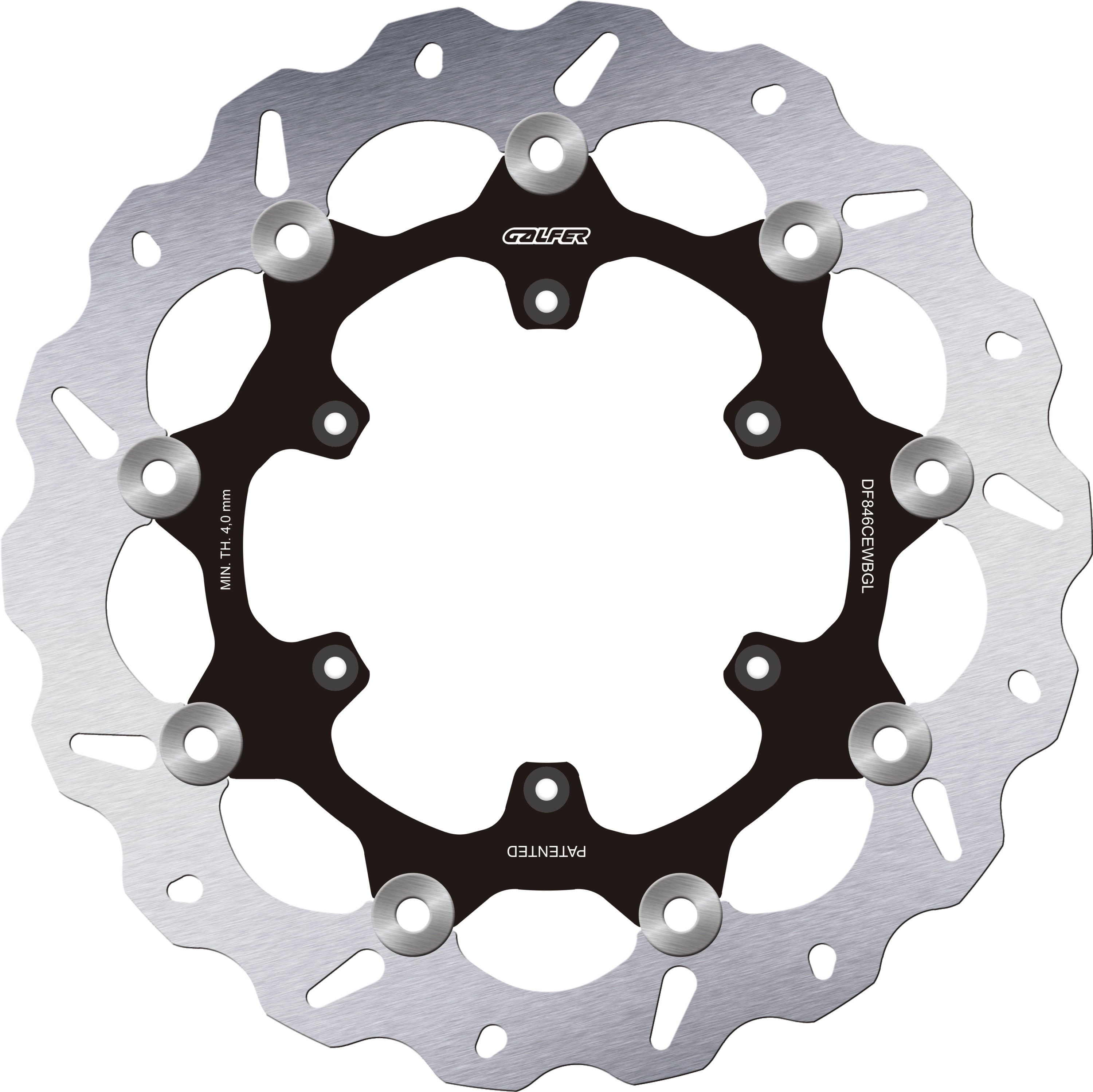

i dont even know anymore... on Galfer website says that the D606SM is for the REAR not the FRONT. The FRONT is the D607 for the Stark according with Galfer, doesnt makes sense to me anyway. Look at my above post with the screenshots
The DF606SM is a 320mm front rotor. All the 607's are rear rotors. I think they just transposed their numbers on the chart.

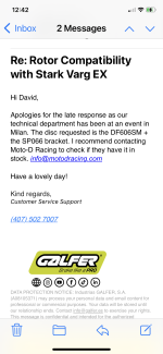

The DF606SM is 4.5mm thick, but the factory EX rotor is only 3.2mm thick according to Google AI. Is there any way to use that rotor on the EX?
EDIT: I just emailed Galfer and asked them if they have a 320mm setup for the front of an EX. I'll let you know what they say.

The DF606SM and it is 4.5mm thick, but the factory EX rotor is only 3.2mm thick according to Google AI. Is there any way to use that rotor on the EX?
i have this exact one:
Disco de Freno Delantero Flame KTM EXC / SX (260 mm)
i dont know how thick it is but is thicker than the stock one and it fits with no problem
is the 260mm version but it should have the same thickness than the 320mm, maybe im wrong

So, is the DF606SM rotor is compatible with the EX? If so, which adapter would I use?
Yes, This is the disc I ordered. I got the KTM brembo spacer. part number 77013914000. The disc is 4.5mm while the stock is 3mm so there was a little rub on the caliper spacer at first. I shimmed the wheel 1mm away from the disc side fork, but eventually removed approx 0.5mm of material from the caliper spacer where the disc rubbed.
After reading your post, I did a little research. It appears the KTM 320mm disc is 4mm thick. I’m assuming their caliper adapter bracket is made for that thickness of rotor. That’s probably why your brake pad (left pad?) rubbed on your 4.5mm thick disc. I’m guessing that if you had used the KTM rotor you would not have had any rubbing.
If that’s true, Galfer probably made their caliper adapter adapter bracket (part# SP066) to work with their thicker 4.5mm disc so that the pad won’t rub, meaning it probably spaces the caliper out (to the left) an additional .5mm over the KTM part.
I’ve made a couple assumptions there. What do ya’ll think of my logic?
Edit: Basically, I’m guessing if your disc and caliper adapter bracket are the same brand, you shouldn’t have any problems with uneven rubbing of the brake pads.
