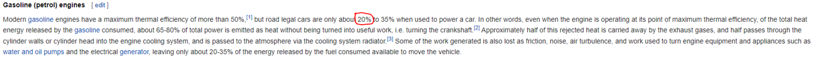

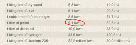

Well if you use 10l of petrol for a total ride time of 1 hour.
With a estimated efficiency of 15%.
It would be 9,1x10x0,15= 13,6 kWh you would need in battery power for a rough comparison.

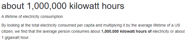

You would only need 130 gram for a life time of energy, how harmfull could that be :D
