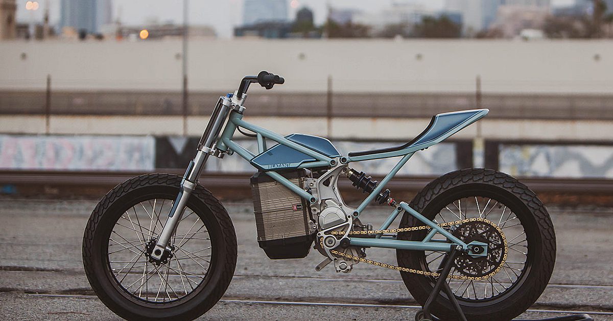

Entire world loved and still longs for the SXV.
This is my favorite version.
Never seen that version. Wild. The engine was such a beast when it was running right but was prone to issues and there is one guy here in the states that everyone sends it to for rebuild. Also was a mess to do a catch can for the oil rebreather. Don’t miss all that stuff but it opened my eyes to the fun of a supermoto.
