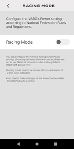

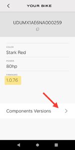

New updates were pushed allowing more interactions within the Stark Future app. Looks like we have the ability to enable race mode with some parameters involving OTA firmware pushes directly from the phone. These new options are within your app settings.

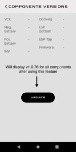

I was able to successfully upgrade all to v1.0.76 across the board for all components. If anyone has a flashing yellow light post upgrade on the bike, just repeat the upgrade procedure (holding (+) & (-) for 12 seconds) which will fix any integrity checks to the upgrade. Proceed with caution using this new update feature see that it is brand new. I would only experiment with this update feature if you are knowledgeable with troubleshooting and do not mind emailing back and forth with Stark. Also I would not use it for current known issues. Please reach out to Stark when experiencing persistent issues.

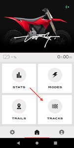

Unfortunately, I do not have any changelogs regarding the bikes firmware, but have included a general list from the app. Note, the track feature icon redirects you to the parts link; looks to be a bug.

Really curious about what they plan to do for those that may wanna race more than 1 class on a weekend of racing….?
One of the benifits to having one of these is you have 5 bikes in 1. You can have any power level so a guy racing 250 and 450 locally couldn’t do that with one bike in this scenario. You’d need to have another bike still cause you’d be locked out of that second class under “race mode”

It is nice there's an update button in the app now instead of having to use the 12 second button hold.
