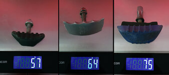

I just installed ultra heavy duty rear tube in my 18" rear tire. The trick is to insert the rim on both sides of the tire (similar to doing tubliss install). That allows a lot of room to install the tube between the rim and the tire. As you install the tube, bounce the wheel on the ground to force the wheel deeper into the tire as you work your way around the tire. I know it means levering on the tire on both sides of the rim once the tube is installed, but for me it's much easier than trying to cram a tube in while fighting the small opening between the wheel and the tire if one side of the tire is already levered onto the rim. Another trick is to use tire grease (search on amazon). It makes installing tires so much easier than without it, especailly in cold weather. Using the Baja No Pinch tool with tire grease makes it so easy without worrying about pinching the tube, and scratching the crap out of your rims. For a cheap tubliss equivalent, use Muck-Off tire sealent for mountain bikes and squirt some inside the heavy duty tube. That stuff is awesome for mountain bikes as it doesn't dry up like Stains sealent. Another bonus it's water soluble (as with the tire grease), so it's easy cleanup. Now you can run low tire pressures with a near bullet proof cheap set up.

Yesterday i took out the stock tube as delivered in a 19' rear wheel in december 2024. It was not leaking, just to prevent it.
It however is much thicker than the November 2023 one and had a rubber flap over the part where the rimlock is (that's where all the old ones started leaking. So maybe they will actually hold now!

I preemptively replaced my tubes this week on my EX. I don’t trust them. The rear tube had a rubber flap/doubler over where the rimlock would contact tube. I noticed too that when I went to remove the Schrader valve core the entire metallic portion of Schrader valve spun in the red tube connecting the main tube.
After tire reassembly, I balanced both tires and wow, how much smoother the Stark became. Very noticeable.

That was the right move. My first Varg (MX built late 23) the red tubes lasted one hard enduro ride. My new Varg (MX built mid-late 2024) red tubes lasted two hard enduro rides. Almost made it to three but no such luck. I used IRC heavy duty tubes as the replacement last time with 0 problems.

I actually like a heavier rear tube in the Stark on MX. Makes it more controllable in the air.
Agreed.
For me I can run heavier tubes to pretty low pressures, not like a mousse but much lower than the red tubes. They didn't like under 10psi and some of the muddy wet terrain was just not something they were well suited for.

Yes that is probably true. The red tubes especially did not like enduro things such tree hops or rock gardens where severe uneven point pressures are applied. Also, the plastic material seems to become "slippery" with water invasion as opposed to rubber which seems to remain tacky even when wet. At lower pressures it is recipe for failure. In MX as long as it is not a mudder they are probably better.

Stark red "Power Tubes" are still a throw away item.
Puncture at the stem after 50km/2h of use. Pressure was 0.9bar/13psi.
I haven't had a puncture in years using rubber inner tubes on this terrain.
It's possible that a nut on the stem would help.
Has anyone tried to patch these TPU tubes? What did you use?

I didn't bother with trying to patch them. Even the improved version didn't work for me and the kind of riding/pressures I use.
