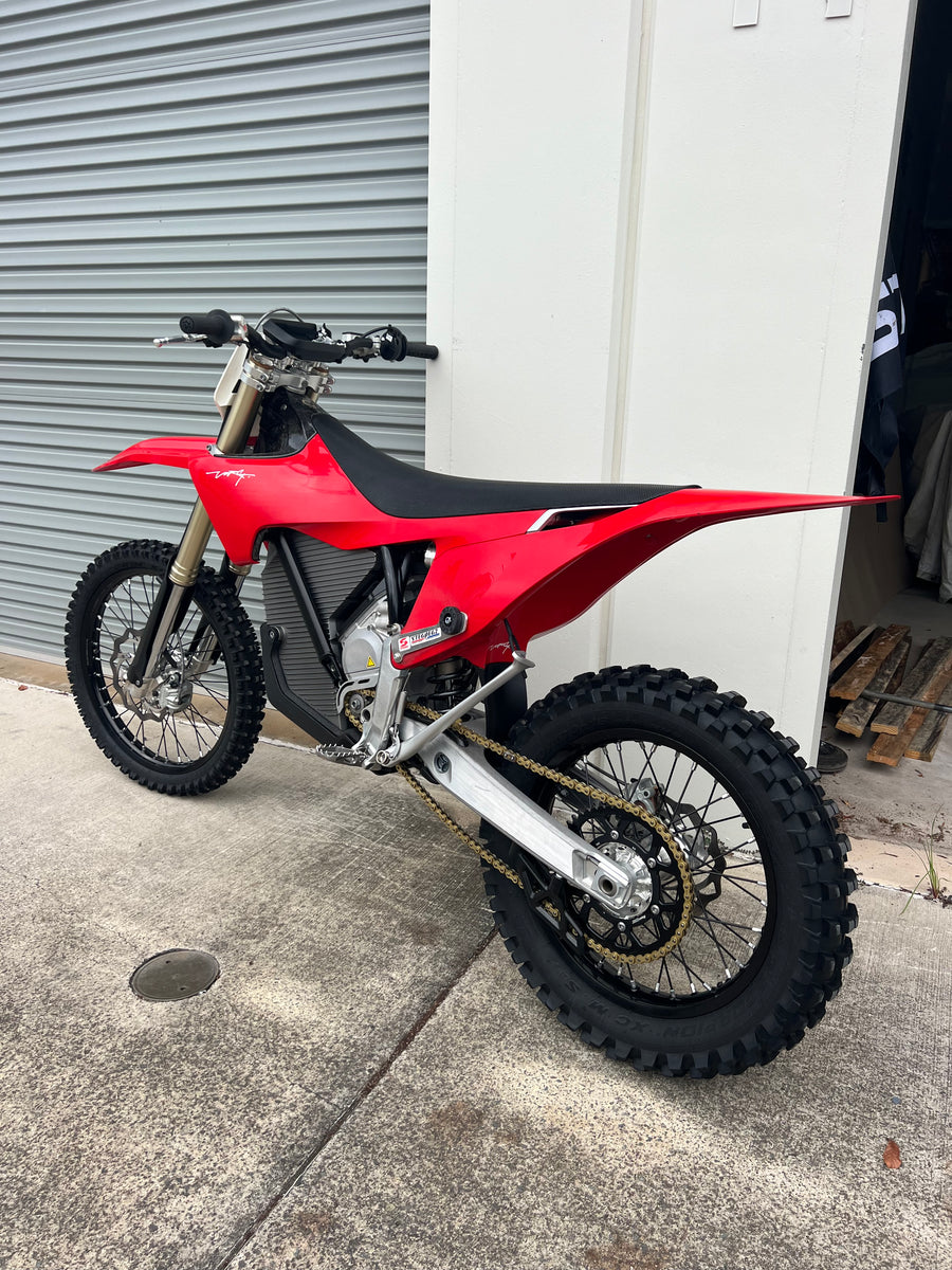

Here's the latest to my Varg mods. I will certainly have a few iterations to get it perfect. And by then I'm sure one of the big companies will have something available. I feel much better dropping my bike on the hills and watching it slide around. I added 1/4" felt to the inside of the plastic where it touches the gear case.

The linkage guard. Is that attaching to the existing holes in he plastic guard?
Upinsmoke57
No. It's easy as can be. Just made two holes behind the cross member. I then melted away the foam so I could get a socket around the nut. If you take the skid plate off it should be pretty clear how to do this. You could even put another bolt up in front of the cross member. But 2 is fine.
