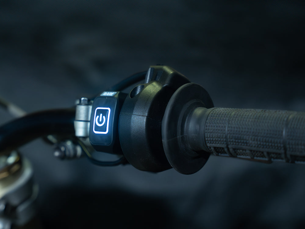

You could buy a whole new switch from Stark for $89, is there a way to use that switch? Does it have the correct ends? Would it be possible to repurpose the kill switch on the throttle side of the handlebar?
finn
1
Aachen
No, it's only a button which is switched by software and uses a Higo Micro M connector plugged in under the docking station.
