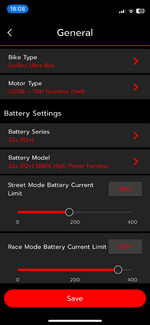

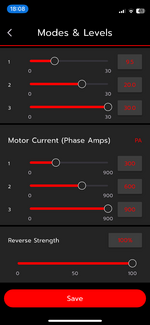

Here you go:
Bike type chose surron ultra bee
Your QS138 motor
After that it will do a motor calibration keep the rear wheel off the ground during that as it will spin slowly.
For battery choose your voltage and set it to EBMX high power harness.
If you choose unlimited you will be prompted for the password.
Beneath that you can save the Amp limit of your street and race mode.
I only use the three race modes.
The max you can set is 400A but 350A is already plenty 😅 the controller can also do up to 500A but to get higher than 400A you need the special password that I will sent you in a private message ;)

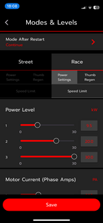

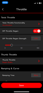

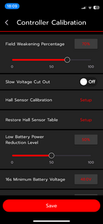

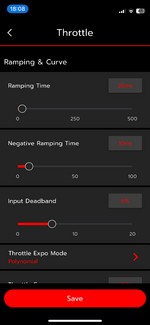

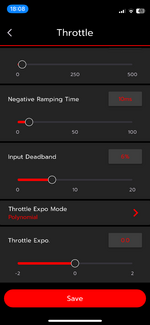

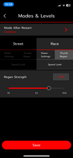

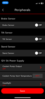

The rest of the pics that I am posting now show all the rest of the settings. Most of the values is best practice and have worked well for me.
My 3 race mode settings are mode 1 to cruise around in the pit, mode 2 is what I use on the track, mode 3 to show off other ppl what the build is capable of (that’s still far from max but already ridiculous).
IMG_3343.pngIMG_3344.pngIMG_3346.pngIMG_3347.pngIMG_3348.pngIMG_3349.pngIMG_3350.pngIMG_3351.png

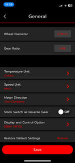

oh forgot to explain this one:
2025_06_05_08_02_55_2020_Honda_CRF_450_Build_Electric_Dirt_Riders_ALTA_Redshift_and_STARK_Varg_F.png
Both values need to be correct otherwise your speedometer won´t tell the truth
wheel Diameter in Millimeter is from ground to top of your tyre so the complete wheel not just the rims:
the Gear Ratio value is:
Inside QS138 Reduction Gears (gear #1 is 19t divided by gear #2 is 45t): 2,368
Your sprockets as you wrote earlier front 13t sprocket divided by your rear 52t sprocket = 4
then you multiply both numbers (2.368 * 4) and you end up with your gear ratio 9.47 thats the value you set in the controller

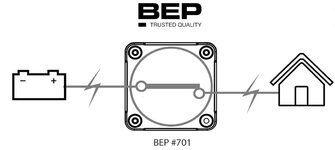

Yesterday I finished the last of everything except wiring the master battery disconnect and resistor. I just need to create a break in the positive electricity flow using a BEP disconnect switch.
1. I'll take positive 4 AWG cable coming from the battery and cut and solder new lugs on to both ends of the cut cable.
2. Then I'll connect of the lugs to the separate terminals on the on/off switch.
3. Next I'll run the positive wire connecting the on/off the switch to the controller B+ terminal.
4. Finally I'll do the fist power up.
The bike is very close to being finished. Wish me luck. Thank you @fmxxx666 and @DonCox for all your guidance.
