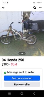

Hello, I've been reading many great threads here and researching other conversions on YouTube. So I decided to pull the trigger on this roller that I found on Facebook. Drove a couple hours away to pick it up. Took a bit of a chance and hung it on my bike rack, but it was fine.
Anyway got it home and started teardown, but i found something very wrong with this Honda.
Anyone have a guess what it is ?
Jim Beagle
39
Placida, Florida
No its not stolen, thankfully. But there was something about the frame design that didn't quite match the pics I was seeing online...
So after quite a lot of research on the VIN codes, I figured out that it is a 2015 Suzuki RMZ250. My first motorcycle was an air cooled 1977 RM125, so this project takes me back to wrenching on bikes in high school. 😎
