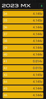

Should i be worried over those 2 cells?

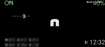

Thanks! The screenshot is very helpful, I'll keep working on getting the display of items fixed for different screen-sizes and layouts.First ride, left arkenstone at home.
Connection shows up a PIN each time, but it can’t be entered and it connects anyway. Took font size to the smallest size possible but ODO is clipped on start screen and
advanced measures overlap speed.
(Must learn taking screenshots on android

This was during charging. Afterwards it were just 0's.Interesting, are you on an EX or MX? My guess is these readings are wrong as that low of a cell voltage is basically impossible (unless the connection to the cells is severed completely). It's also very suspicious that both readings are so close to eachother, and they also look like a delta reading since 0.015v would be a very common cell-delta. If your on an MX I would guess the firmware is maybe a little different or possibly I need to do some more investigation. Either way if you want to use the "export diagnostics" feature and send me the resulting file I can at least take a look to see if there is an obvious bug in the app.

Interesting, I can't promise everything is compatible with the MX series, from what I understand the app for it (unless its been updated to match the EX one) uses a different Bluetooth interface/version. Given that it's possible some data is incorrect or nonsense on the MX series. I do believe they are working towards getting the MX series onto the new interface and app, so thats probably why a lot of stuff is working okay.This was during charging. Afterwards it were just 0's.
I wanted to look into it some hours later and the app couldn't find my bike. Will try again today.
This bike (MX 2023) has warranty until november. With this info i will make use of their extended warranty i guess![]()

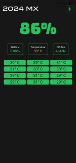

Could you take a look at the battery sells if they're all the same or also 2 0's?Everything works well for me on mx
it's strange only with the version in the stark application it shows 1.2.0 in your application 1.2.8 which seems to be true since there were no more updates
