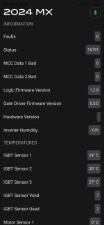

it works, the only thing is that my humidity was showing with a minus sign, I'll attach a screenshot now
once again, a huge thank you for the app, now when buying a used bike you can check the battery and understand in general what and how, a very useful thing!1000331910.jpg
