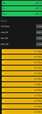

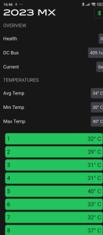

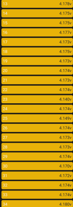

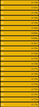

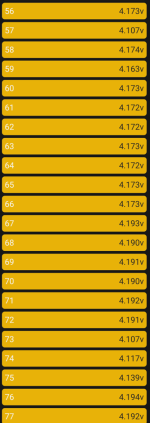

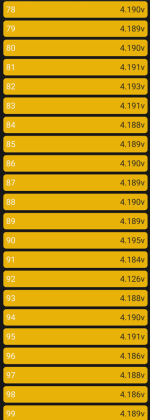

Hello Brongle, first of all thank you very much for your incredible app...
The cells group are exactly the same as Erwin 41 and 42 groups.
Yes the porcentage drops and also the voltaje, for example I charged my bike to 400V 95% and the second week in standby the total voltaje was 388.5V. (78%).
Sorry for my English I´m from Spain. I want to say that my warranty is expiring in november 25.
Here they are my data from battery.

Interesting, thanks for sharing the screenshots. I still don't really understand how this failure mode could even happen, I can understand a single cell going bad but to consistently have two entire cell groups get disconnected seems very suspicious. It's also shocking this displays no errors to the user, doesn't fault the BMS, and seemingly doesn't raise alarm bells on Stark's diagnostics tools. I guess as an EX owner it's time to pray Stark somehow fixed this in the new packs, although that seems unlikely given it was supposedly just a cell upgrade.
From my understanding the vast majority of Stark's support staff are relatively non-technical so it's not too shocking they identified it as a cell imbalance, they probably can't even see the individual cell group voltages. The incoming support cases get triaged by this staff and then as needed some of Stark's actual engineering staff are brought in. I'm guessing that would be the next step after their bottom-balancing instructions inevitably fail for you, and hopefully then they can correctly diagnose the issue and get the pack warrantied.
