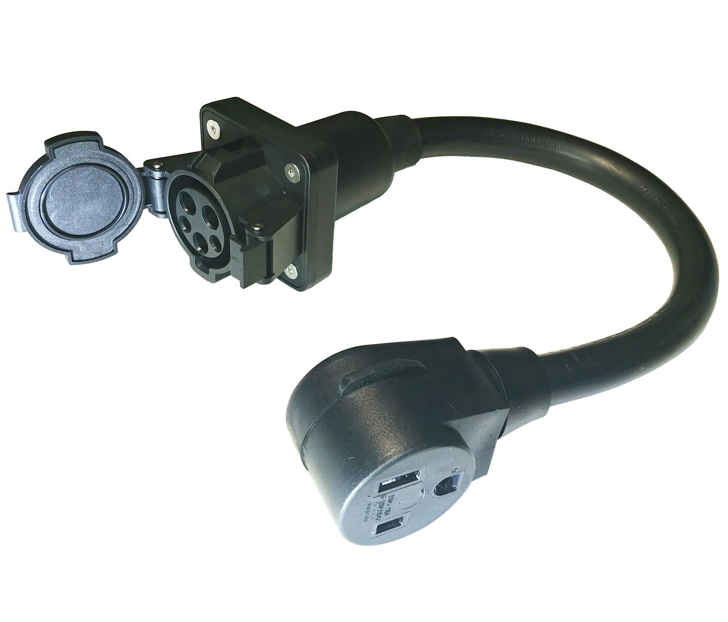

  • NACS (Tesla) → J1772 adapter (A2Z Stellar)
  • J1772 → NEMA 6-50 EVSE adapter (must emulate a vehicle)
  • Stark Varg charger (mounted in portable case)
Setup chain:
Tesla Charger → A2Z (NACS→J1772) → J1772→6-50 adapter → Varg charger

  • Your J1772 → 6-50 adapter needs to properly emulate an EV (cheap passive ones won’t work)

The J1772 adapter I used is from EVSEAdapters:
Note for the J1772 to NEMA 6-50 make sure it actively emulates a vehicle (important). Cheap passive adapters won't work.
