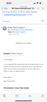

Have you reached out to Stark with that info? Asked them to confirm if they are or are not paying dealerships for warranty work? If they are not, maybe ask them what other solution there is for your bike since dealership won't release bike of not paid for labor?
At the moment dealer and stark are supposedly communicating about what I’m not tied to their emails so I can’t see what’s being said and done but stark has commited to paying the labor and obviously cover parts under warranty I I have that in their email sent to me and I sent to dealer so they understand they will be paid for their labor. Now it’s seem it’s just a waiting game to see if they order the parts so we can move forward to get this done. As I was typing dealer called said they ordered the drive train but refuse to order a battery that stark specifically mailed me and them and told them to order. They refuse and said stark won’t let them order a power train and battery at same time and if they need to they will order if needed after powertrain install! Which is nuts I believe the batter may have a bad cell also since this all happened after a full charge and Interrupted update. So dealer is the one playing the games dealer reiterated and said stark wants them to pull a new battery from one of the new bikes in the floor the dealer refused and said they wit be able to sell it if they do that! So dealer is the one playing the games not stark in fact!!!
