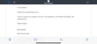

I have tried it all all steps that can be done I had the bike apart and tried the holding buttons disconnect the black circle cap on side of the battery then hold power button when reconnecting it and releasing it within 3 seconds I hav tried it all and nothing works!

If you can see you info in the app then that's a good sign that it may not be the owner issue. If you had multi colored flashing lights, it was updating, and stopping in the middle is a no no. I don't know if disconnecting and reconnecting the battery would work? They really don't want untrained people doing that, but it's just a plug. I'm thinking now that you interrupted the update and it bricked. I still think they can reset it, but sometimes faults are found during an update and they end up sending a new battery or something. Good luck with it, hopefully they get you fixed up quickly.

Well you want the good new or the bad let’s start with the good: stark wants to replace the complete powertrain to a gen 2. They want me to take it to the dealer, the dealer that sold the bike no problem, call the dealer this morning after loading the bike let them know that I’m bring it and why they proceed to tell me not to bring it because stark is not paying labor cost and to wait to bring it when powertrain arrives and it is in its way. So now they say they won’t release the bike once they have it and powertrain is installed if stark future does not pay the labor cost! So my bike will be held hostage this is some F’d up stuff dealer is apparently taking over my emails with tech support and trying to get it handled supposedly but they claim they have power trains on the floor in their shop new that they have not installed due to not receiving labor cost or warrant replacements! This is some. Authorized dealers k ow they will get paid but they are jamming customers up and stark knows this and it is in fact some BS but dealers keep taking in new inventory! Like wtf. So I’m at the point like wtf do I do now with this expensive paper weight!

I have some news about my red light issue, probably due to a faulty drivetrain.
The asked me to :
  1. Check Connections: Ensure all connections, especially those related to the powertrain and battery, are secure and free from debris or corrosion.
  2. Inspect for Damage: Visually inspect the powertrain and related components for any signs of physical damage or wear.
I did it, and everything was fine. They asked me to book a troubleshooting session, which is scheduled for tomorrow at 1:30 p.m. local time.
I contacted them several times, and they always answered quickly. They took a bit longer to respond to this issue, but not by much.
First contact on Sunday 17 => Aug 19, 12:25 => I replied on August 20 at 12:38. => Aug 21, 11:57
