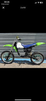

Hi All not sure if this thread is still Active but I’ve being looking into building converting a dirt bike over here in Ireland for a while now, I’ve being waiting on a decent donor bike to pop up and found this the other day. Appears to be a 90’s kx 100 with no engine for a couple hundred euro.. Would this be a good platform to build on?

Hello Mr. D_Daly, welcome to the Forum. Yes your bike works perfectly for this type of build. Go to post #11 in the article, (Your post is post #26), the first picture in that post is a "90's model that I build. A bit different in the motor mounts and a simpler shape for the battery. The motor has to sit real low in the frame, and on the model I welded tabs onto the frame for the motor mounts, and ground fin off the motor to get it lower i=on the frame. Do you weld, or can you get it done? This makes it much easier. Also the controller mounts need to be welded on. I have found the best motor for this setup is a QS138 70H V3, with a Votol EM150SP/2, and the battery that we can fit in it is a 20S8P. Using the Samsung 50S cells you can get a save riding distance of 30 miles.
To fit the battery it is tight, and we cut the top mount off the motor. I will include a few pictures, ask any other questions. I have a few used but good EM150SP/2 controllers, I could load a good tune I use for this size bike and sell it to you for $200 and shipping costs, or you could buy it from Aliexpress too The motor (you should get the new upgraded one) you can get from Aliexpress, or I could sell you one of those also too for $500 plus shipping. I could cut the top mount off for you, but you would need to grind the fins off the bottom of the motor to fit your frame.

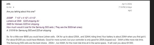

The battery Amorge said they could build it for me, and here are some approximate prices as of about 6 months ago. They put them in a nice metal case and should fit really nice,

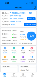

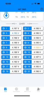

Is this the BMS?
What do you do to make make the battery waterproof enough?
585
If you look at the complete open battery above in pic 5931, you can see the bottom tray. The bottom tray wasn't complete in pic 4352, and those batteries were from a KTM Freeride (There was another row of cells on top of the flat group already there.). I could only make it 20AH 72V for the KX100 it went into. Then I build the top out of 2 parts. pic 4620 is the side the is bolted on with nylon screws,( also that is the charge port) and the rest of it is bent plastic and welded plastic in Pic 4621 RTV at all the joints, and they are pretty good to get wet, but not submerged. Amorge batteries are in the steel cases, are water proof, but not submersible either. They don't boast of any IP65, 66, or 67 rating
That is the BMS in the picture you pointed at. An ANT Smart BMS, pics 8222 and 8223 are what you see on your phone so you can monitor all your cell groups
