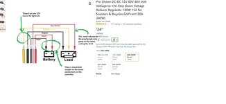

You will see, that if you don't have the surge resistor on the Master contactor or Master ON/OFF switch , it will arc every time you turn the switch on/off. It will burn up some switch's. Here are 3 pictures. One is the DC to DC converter I use, because it has a soft start circuit, and here is a overall schematic , and one is the wiring to the EM 200SP controller.
Thanks Don, i got the EM200-2SP + the wire harnass and everything i need to get 12v for lights and everything. Also including a display and some keycontact . But in this kit there isa relay but im not sure its strong enuf to serve as the relay to connect the main + to the controller.. See the image below.
So i'll be buying one of those power brakers, and bridge them like u did. -> https://www.amazon.com/dp/B099WKJPBD/?tag=sce0f-20
